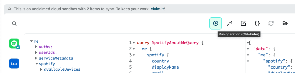

  4. Select an example query or create your own.
  5. Select Run query to get your data in Graph Explorer.

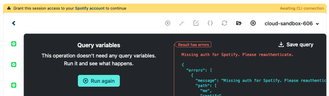

  6. If needed, grant access to your service account by selecting the Grant this session access prompt and entering your account information.

    If needed, grant access to your service account by selecting the prompt and entering your account information. You can experiment by changing the query variables and selecting Run again until you get the results you need.

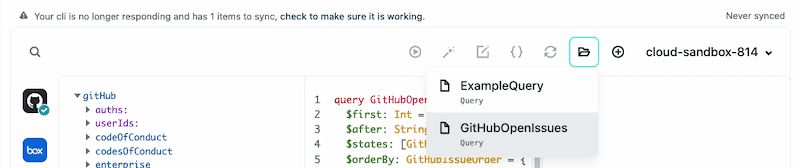

You can access example queries at any time in the same way as above. You can also use the folder icon on the graphical interface.

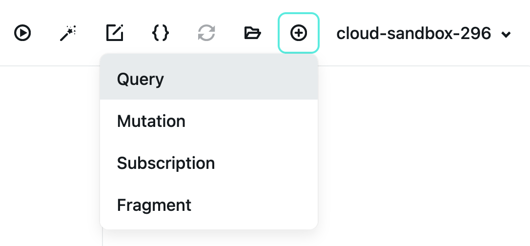

  2. On the left side of Graph Explorer, find a service you want to integrate with from the list of services.
  3. Select Create team operation, then select Query.
  4. Replace "ExampleQuery" with your own query name and compose your query.
  5. Select Run operation to get your data in Graph Explorer.
  6. If needed, grant access to your service account by selecting the prompt and entering your account information.

  3. Select View team operations, then select the operation you want to generate a handler for.

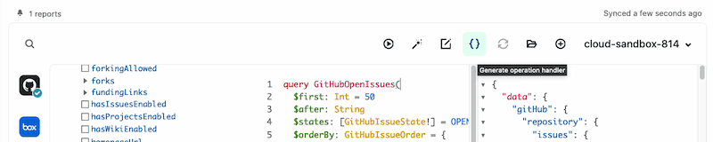

  5. On the right-hand side of Graph Explorer, select Generate operation handler, left of the folder icon.
  6. The CLI creates a handler for your operations.
