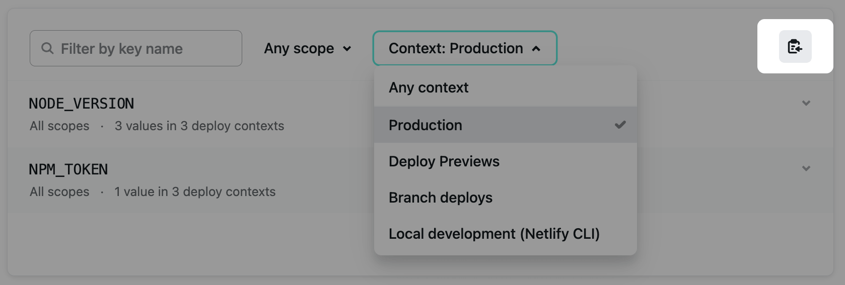

Section titled “Export variables with the Netlify UI”As .env files include variables for a specific environment, you can export environment variables from the Netlify UI for each deploy context.
- Navigate to Project configuration Environment variables for site environment variables or to Team settings Environment variables for shared environment variables.
- Select a deploy context in the Context filter.
- Select the clipboard icon to copy the filtered list in
.envformat to your clipboard. - Paste the results in your local
.envfile or import the variables into another Netlify site.

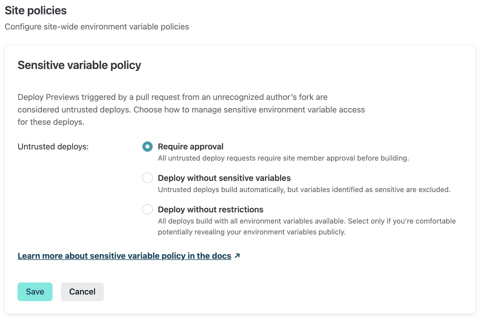

Section titled “Untrusted deploys and sensitive variables”If your project is connected to a public repository, Deploy PreviewsDeploy PreviewsA type of deploy that lets you preview and share changes for feedback before they go live. from forks are handled by your project’s untrusted deploys policy.
If your untrusted deploys policy is set to Build without sensitive variables, untrusted deploys build automatically, but variables identified as sensitive are not passed to the deploy environment. This means that extensions or integrations that rely on those variables may not work in these Deploy Previews. Learn more about the untrusted deploys policy options.
You can adjust your project’s code to accommodate builds without sensitive variables present, or you can set a separate value for the deploy-preview deploy context that’s safe to expose publicly.
Netlify always treats an environment variable as sensitive if it’s marked as Contains secretsecretSensitive credentials, like passwords and API keys, that must be kept private. values (via the Secrets Controller feature). For variables not explicitly marked in this way, Netlify automatically attempts to detect if the variable is likely to hold a secret.
Automatic detection looks at both the variable name (e.g., names including terms like PASSWORD, TOKEN, SECRET, API_KEY) and its value (e.g., values that match a known credential format such as AWS access keys).
Automatic detection is based on heuristics, so to make sure a value is always treated as sensitive, it's best to explicitly mark it as Contains secret values.
