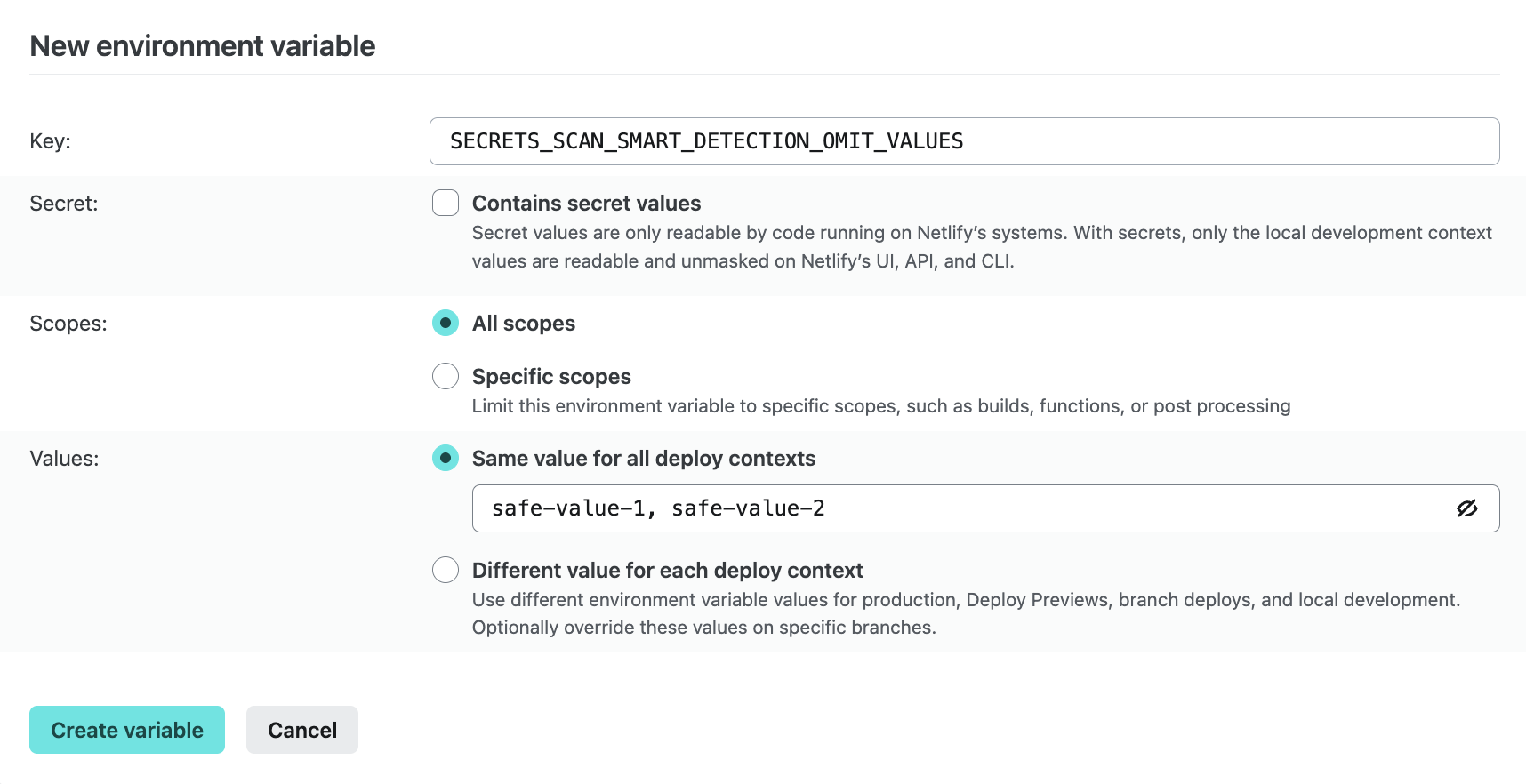

To add a false positive to a safelist:
For your project, go to Project configuration > Environment variables and choose Add a variable and then Add a single variable.
Give this variable the key name
SECRETS_SCAN_SMART_DETECTION_OMIT_VALUES. -
Add the strings you want to add to the safelist as the value of this variable, separated by commas for each false positive and then select Create variable.

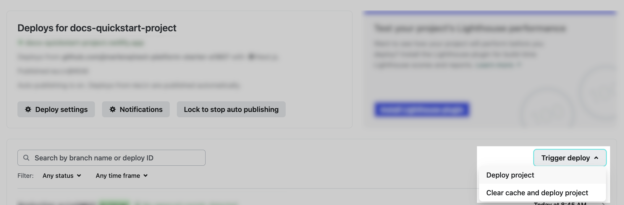

To re-deploy your project, go to Deploys and choose Trigger deploy > Deploy project.
