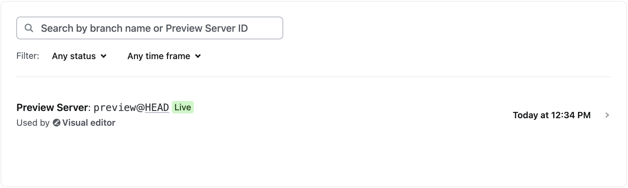

# Step 5. Restart the preview
  1. Confirm you have merged changes you made in stackbit.config.ts into the visual editor's working branch, which is preview by default, on your site’s remote repository on GitHub or BitBucket.
  2. If the Preview Server for the visual editor was already running, it will automatically restart. If the Preview Server was not already running, it will start automatically when you open visual editor.
You can verify that your Preview Server has restarted by going to
Preview Servers UI showing the restarted preview server
